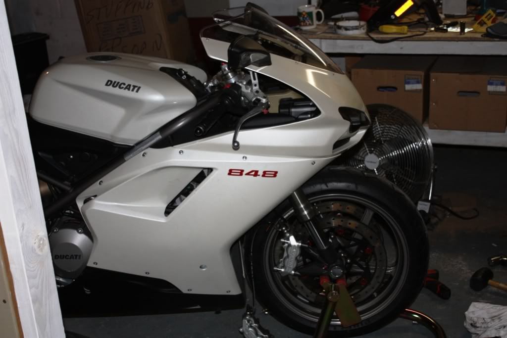

I wasn't sure exactly what it would take to make it happen but my friend recently bought an 09 848 so I decided to try it first on his bike to see what I was getting myself into. I guess that'll teach my friend to leave is bike at my house for the winter. [evil]
Here is a picture of my front wheel installed on his 848.
While fitting my wheel to the 848 I took a bunch of measurements to figure out what was needed for spacers, hardware etc.
