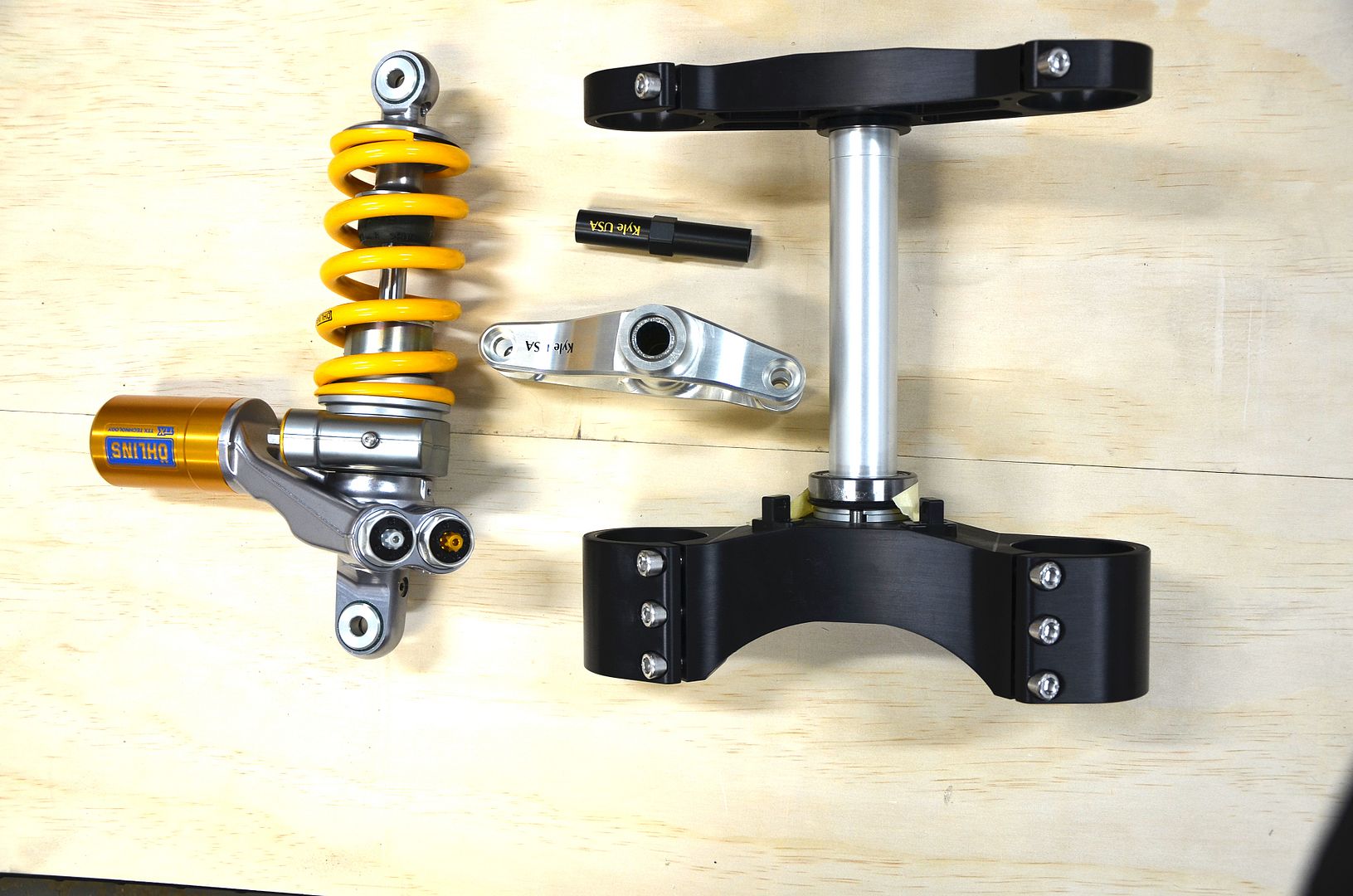

Wasnt it said somewhere that if you upgrade the shock to say TTX36 and go with the linear link, that you need a different spring in the shock, different ride height rod, and ideally shorten the shock to fit the link? Probably cheapest to do all that at once, rather than pay twice for some items?
I just went the Kyle Racing route. Decided to go with the TTX shock and the Kyle linear link as the shock is designed to work with the link from a length as well as spring standpoint.
The TTX-GP shock explicitly states it cannot be used with the OEM link and is designed for the liner track link.
So just a word of caution, make sure the link and shock, you plan to use, are compatible.
Both are on the bike, but it'll be a couple of months before I get to ride it.
Although I bought the Kyle Ride Height Adjuster, I had to send it back to Kyle Racing to have them shorten it from 94mm to 90mm to get a 230mm ride height, using the Kyle Ride height tool. They suggest a ride height between 230mm-240mm. Without the 4mm machined off, I could only get a 238mm or higher ride height.
Reactions: 1
Their suggestion was to go up 10Nmm in spring (2 steps) and use the Sato ride height adjuster. 1098r was used as the R+D mule. I would likely find right spring rate (sag) and optimum ride height to work with their link and then upgrade shock at a later date. That way you aren't revalving the shock a second time when you change spring
for most linear links, yes this is the case. The forsaken link claims to be a different design that can use the stock ride height adjuster and standard length shock. I would just need a stiffer spring which I can swap out myself.
Actually they claim you don't need to shorten the shock, but must run a shorter ride height adjuster. Also need to go up 2 steps in spring
I'm going to bet it's similar the the now impossible to get Dept of Suspension linear link which was specifically designed to work with unmodified shocks and stock spring rate. I have the DOS on mine and it does exactly what it claimed..... best mod I made for suspension (after the 27mm triple clamps). Well worth the money.
If that link shares the same dimensions I'd expect great results from it.
I discovered an MV Augusta F4 ride height rod is the correct length and range of adjustment for a shorter link rod but it needs a 7mm spacer at one side of each rod end because it's narrower. It also looks identical to the Ducati Corse item and is very easy to adjust.
How do you know which is which? I didn't know there are multiple TTX shocks :confused: I was planning on using mine with the stock link. Is there a way to find out whether my TTX will work with that or not before attempting to put it on?
The cost of having the shock machined + a linear link would be more than I paid for the damn shock...just doesn't seem like an economical way, and I'm on a tight budget now.
