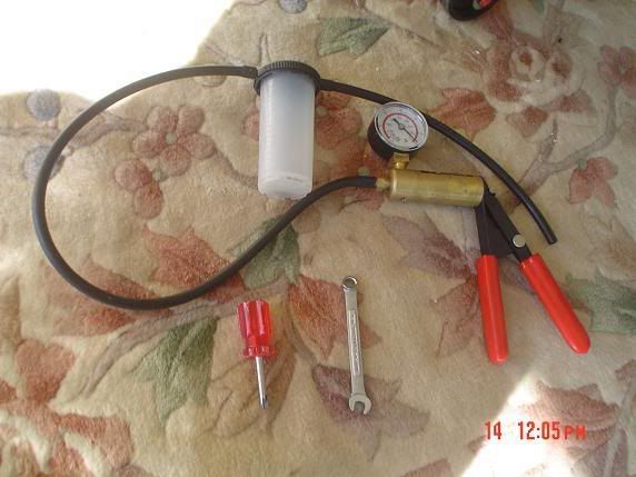

Here are some of tools you will need....
Depending on your bike, but on my triple 9, I am using a small phillips, a 5/16th wrench, a brake bleeder vaccum pump, and a few shop towls
Make sure you get the right brake fluid, here are a couple of choices,
I will be using the dot 4 high temp. racing fluid (getting ready for Tuesdays track day)

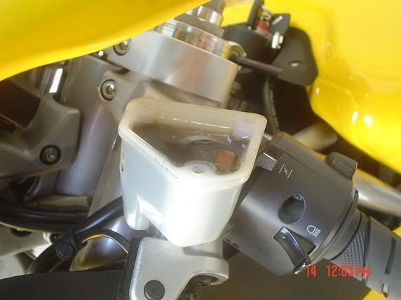

Unscrew the Res. cover
If your fluid looks like this, you defenitley need to change it

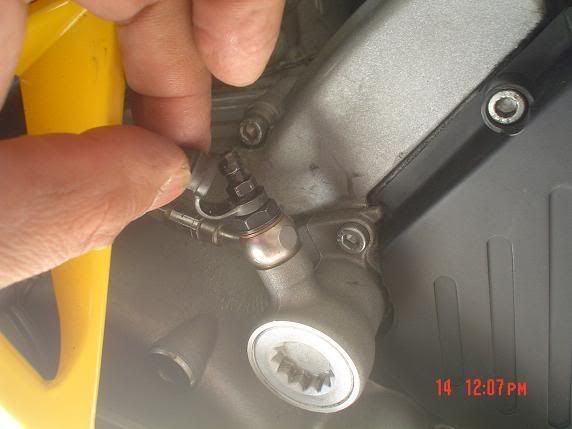

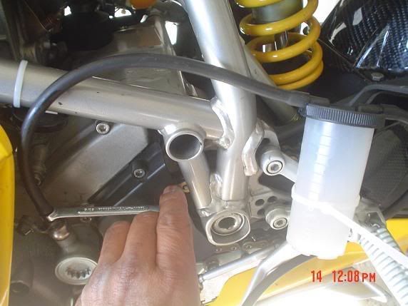

Locate the bleed nipple from the clutch/brake
Remove protective Cap
Place box end wrench on nut and the place hose on the nipple
Loosen nut and then start pumping brake bleeder...
This is what you should see when you start pumping, ( the fluid level dropping).

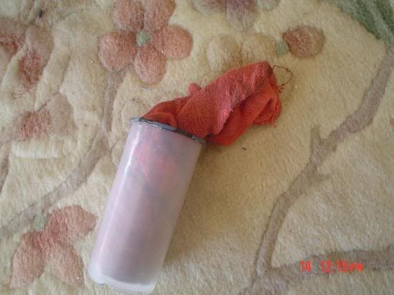

It's all in this cannister
Once done, remove canister and pour old fluid into a oil pan
Then clean the canister really good with a shop towel
If you have a compressor, blow out any access fluid with a blow gun,
make sure you cover the resev. with shop towel to prevent fluid going everywhere.

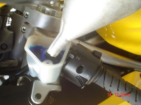

Pour new brake fluid into resev. use a small funnel
Start pumping up to 25lbs. then release pressure by loosening nut to start bleeding brake /clutch.
make sure to watch fluid level up top...add more fluid if neccesery..

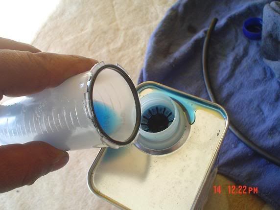

After you are done pour clean fluid back into can

Any chance of you posting a photo of the underside of the cap on that little vacuum bottle you have? I suspect it's just a simple cap with two ports, but I was wondering if there are any provisions in the cap for keeping the liquid from being pulled into the vacuum pump.

Once fluid has been poured out of the can, it's contaminated, more so if it's been circulated through the system. NEVER pour it back in the can with the fresh fluid.

I thought returning the fluid back to the container was a bad idea as well. It's best to do this with friends. The bottle will contain more than enough to do a couple bikes. And once opened, you can't close it and re-use it as it will absorb/collect water. So, once you've opened it, it is toast.

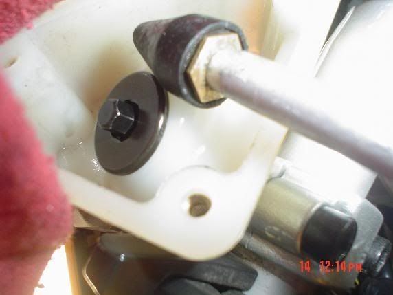

151 Posts
On 999's I'd be cracking open the 6mm black nut inside the reservoir to purge an internal passageway. With it topped up, loosen and pump lever, foaming little bubbles will be ejected. This master cylinder is notorious for trapping a bubble inside top of piston which results in soft brake lever feel.
I need to "burp" mine every three months and repeat on clutch side.
