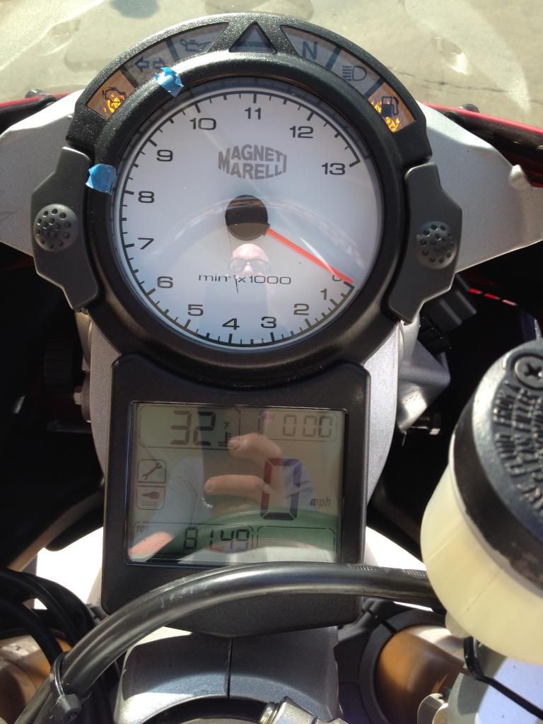

I have a ride coming to pick me and the bike up. Abilene ran fine all day. About 2 miles before I stopped to get gas it acted like it missed a couple of times. After filling up, I turned the key on and the display went crazy. The temp showing 32c. the idiot lights flickering, and the engine light on. So, is there anything I can check before taking it to the dealer ? This is an 03s. When I turn the key on the idiot lights flicker almost like I have a bad connection somewhere, HELP
124 Posts
Discussion Starter · #2 ·
About every 4th try, the bike cycles and the display is normal, but when I push the starter there is a click an all goes blank, then the fuel and engine light, lights up
Now for the first time it turned over but did not start. Battery?

Got the bike back home, took the battery out, tested it and it was indeed a bad battery. Terminals and all were clean. PO said the battery was less than a year old, and it looked it. But it was an off brand name AGM battery. So must have had a cell go bad or something
As noted in my other posts since i got this bike I thought is was dragging more than it should as well as sometimes just would not start until cycling the key 2-3 times.
